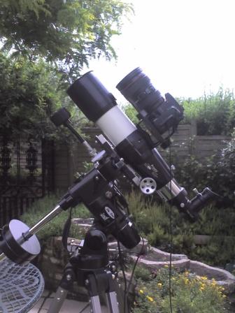

My set-up for the shots to follow is a Canon EOS 400D/XTi with an EF 24-105mm f/4L IS USM. A Hutech LPS-P2-FF Front Filter was used to block scatter from the local sodium street lighting. The camera was set to manual, ISO 800, f/4 and daylight white balance. The lens was set to its widest zoom of 24mm. The Bulb exposure was controlled by a remote switch to stop unwanted camera vibrations. All exposures were 180 seconds for this sequence. Colour information was discarded. Three minute exposures demand that the camera counters the rotation of the Earth so the whole shooting match was mounted on top of my telescope to take advantage of its motor driven mounting like so
The telescope's optics weren't used.

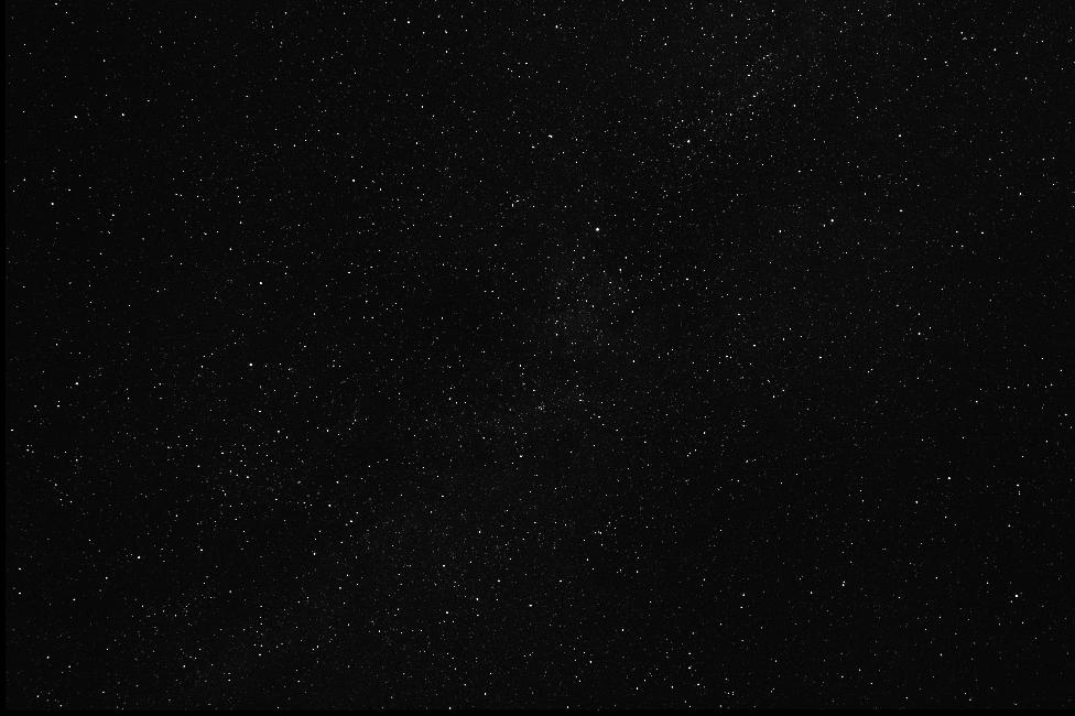

IRIS software was used to process the RAW images. Here's how the shot looks like with virtually no processing except re-sizing
This and all subsequent images are click-able to allow examination of the full size originals.
I took a second three minute exposure of the Milky Way and then covered the lens and took a three minute dark frame
This shows a few stuck pixels and the effect of sensor noise.
The next shot is of this dark frame subtracted from the first image
As before, minimal processing apart from a small adjustment to the image thresholds.
The last image was produced by taking the second three minute exposure of the Milky Way and subtracting the dark frame as above. The intention was to add this to the image above to increase the signal to noise ratio. While I succeeded the result could have been better as, unknown to me at the time, the camera had rotated slightly between shots. To its great credit, the IRIS software did a pretty good job but rotating a digital picture by just a few degrees is impossible without introducing subtle artefacts and those artefacts severely limit the degree of unsharp masking and other tweaks that can be accomplished before they become visible. Here is the result

of the first post in this thread (the photo shows my old 400D/XTi plus EF 24-105L lens) but this time I used an EF 50mm f/1.8 lens
and, of course, the 40D. The camera was skewed around slightly to avoid the main telescope getting in the field of view. The only
reason for putting it on the telescope was so that I could use the telescope mounting to track the stars.
