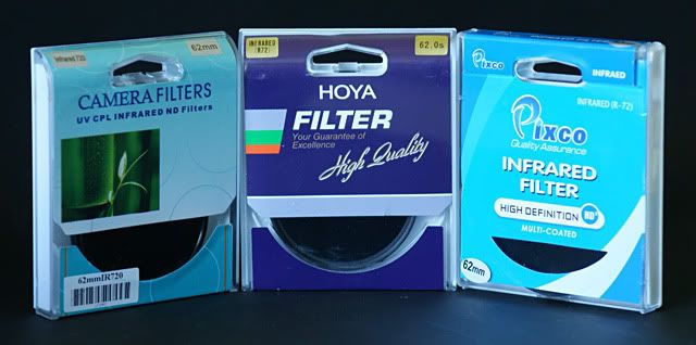

Onto the filters, here we show them in their cases.
On the left is an unbranded one. This was bought from ebay seller link-delight-uk and costs £12 delivered.
Needing no introduction, in the middle is the Hoya R72. A current good price is over £35.

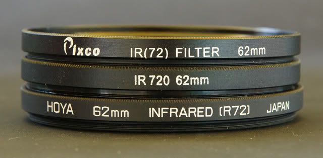

On the right is a Pixco branded filter, bought from ebay seller cam.plus for just under £12 delivered. The case has a link to RocksPhoto.
The filters look much like each other on the outside.
